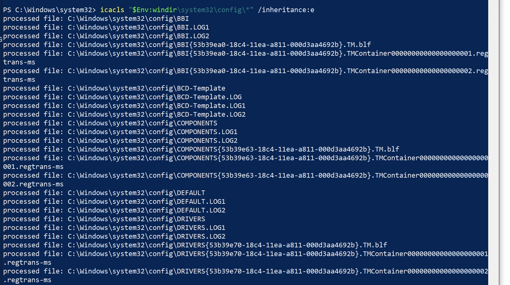

@OROR and @MFKDGAF what happens when you run the command manually on a machine where you see that error?
icacls “$Env:windir\system32\config*” /inheritance:e
Do you get output similar to mine?
Also, do you have shadow copies enabled?
