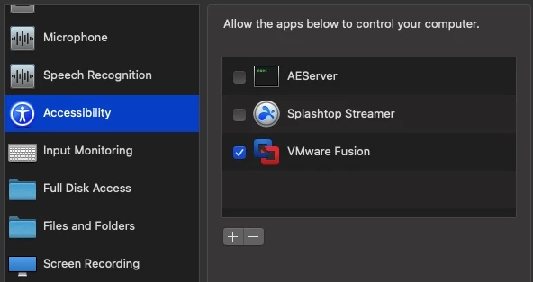

Splashtop requires:
Accessibility
Screen Recording
Accessibility is the only option in meraki MDM but it doesn’t get enabled with any of the options I have tried.

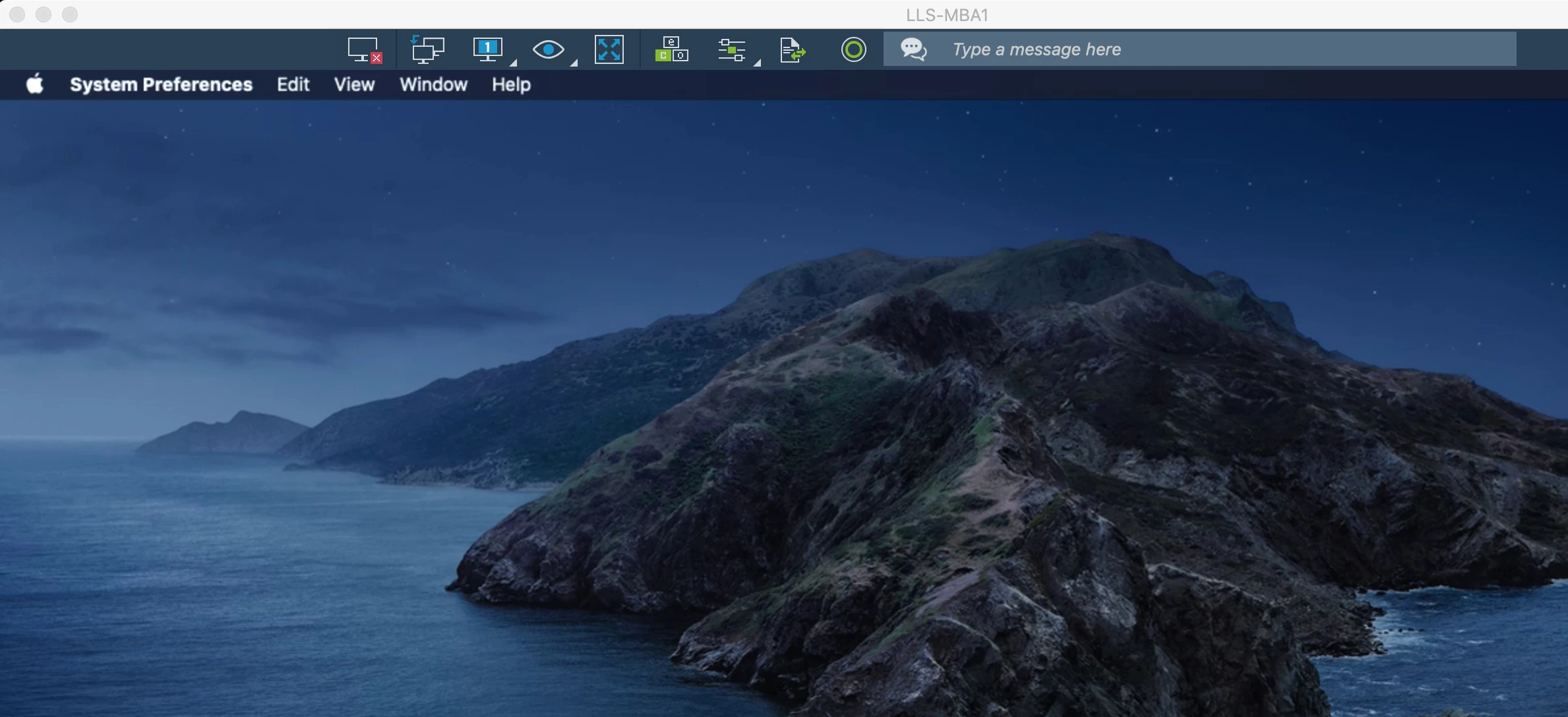

I have tested the accessibility only option enabled unfortunately I wasn’t able to see the users screen correctly.
Only partially the connection was made and I was able to see blank MAC desktop and move the mouse and click with it.
Since I had the test laptop next to me I could see that I am controlling the mac but the problem was I was driving blind since on my end I wasn’t receiving video feed with the current desktop and applications.
here is a screenshot:
on the actual laptop I had System Preferences open.
This is very frustrating situation since we had switched to online remote teaching model and we are trying to support the teachers remotely.

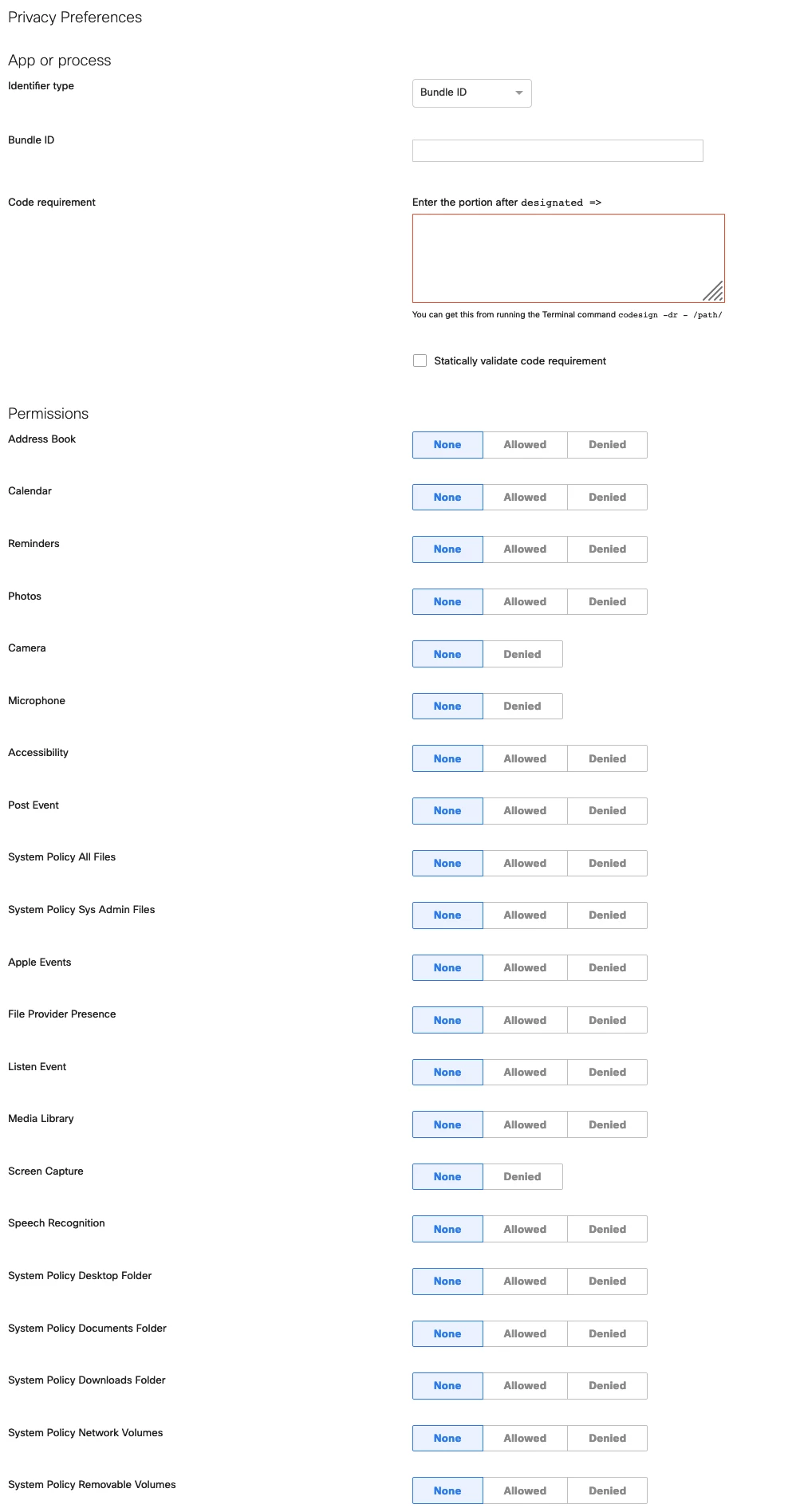

As I am testing every possible deployment I had discovered that on Catalina all is needed is the “Screen Recording” privacy option which can be enabled by any user without the need of admin rights. (doesn’t help me since we have only couple of Catalina macs)
I am not able to get the meraki MDM change the privacy settings using the build in profile configuration or using the tccprofile tool.
I have tried every possible combination I can think of without any luck.
The profile gets installed but the privacy settings doesn’t get changed (Mojave or Catalina)
I am still waiting on any help from meraki because I think if the MDM sets the Accessibility on Mojave macs I would be good to go.
attached is the profile I created using tccprofile
and here is the configuration I am using for the meraki MDM profile:
bundleID: com.splashtop.Splashtop-Streamer
Code Requirement:
identifier “com.splashtop.Splashtop-Streamer” and anchor apple generic and certificate 1[field.1.2.840.113635.100.6.2.6] /* exists / and certificate leaf[field.1.2.840.113635.100.6.1.13] / exists */ and certificate leaf[subject.OU] = CPQQ3AW49Y
I have tried the short version of the Code Requirement as well:
