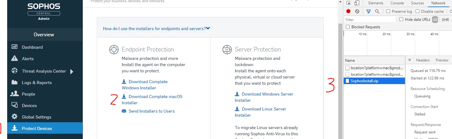

cfriebergFebruary 11, 2021
#10
If that doesn’t work, you can get it in the browser dev tools… hover over that zip file and you’ll see it
Right click, copy url
uapiladoMarch 1, 2021
#11
Thanks @cfrieberg… i finally had time to execute this script in automox. Works like a charm. Thanks again!
