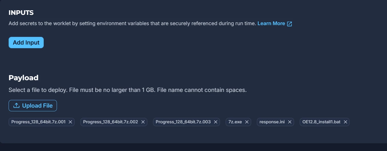

  1. Had to split out package into 3 zip files. (since i don't wanted to use any network location or blob storage, kept split packages under 1gig so, it uploads successfully before Automox times out. )
  2. Uploaded payload one by one.
    Split packages with other required files.

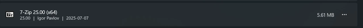

  3. Since 7zip and 7z.exe requires to extract file successfully on endpoint, deployed 7zip to endpoint with separate worklet before hand. Also we using 7Zip as our baseline app so it was already fulfilled requirements.
    7-zip

    $archiveFile = Join-Path $destinationFolder "Progress_128_64bit.7z.001"
    $arguments = "x `"$archiveFile`" -o`"$extractFolder`" -y"
    Log "Starting extraction of split archive"
    Start-Process -FilePath $sevenZip -ArgumentList $arguments -Wait -NoNewWindow
    Log "Extraction complete"
    # Copy response.ini and batch file into extracted folder
    Copy-Item -Path "$destinationFolder\response.ini" -Destination "$destinationFolder\Progress 12.8.1 64bit\" -Force
    Copy-Item -Path "$destinationFolder\OE12.8_install1.bat" -Destination "$destinationFolder\Progress 12.8.1 64bit\" -Force
    Log "Copied response.ini and batch file to extracted folder"
    # Run the installer batch file
    $batchFile = Join-Path $extractFolder "OE12.8_install1.bat"
    if (Test-Path $batchFile) {
    Log "Starting silent install batch file"
    Start-Process -FilePath "cmd.exe" -ArgumentList "/c `"$batchFile`"" -WindowStyle Hidden -Wait
    Log "Batch file executed successfully"
    } else {
    Log "ERROR: Batch file not found at $batchFile"
    Log "All setup steps completed. Installation may take 30–60 minutes. Check C:\OEinstallationLogs for progress."
  7. Haven't spend so much time to clean the script as it was working and giving me what i wanted.
  8. Thanks
