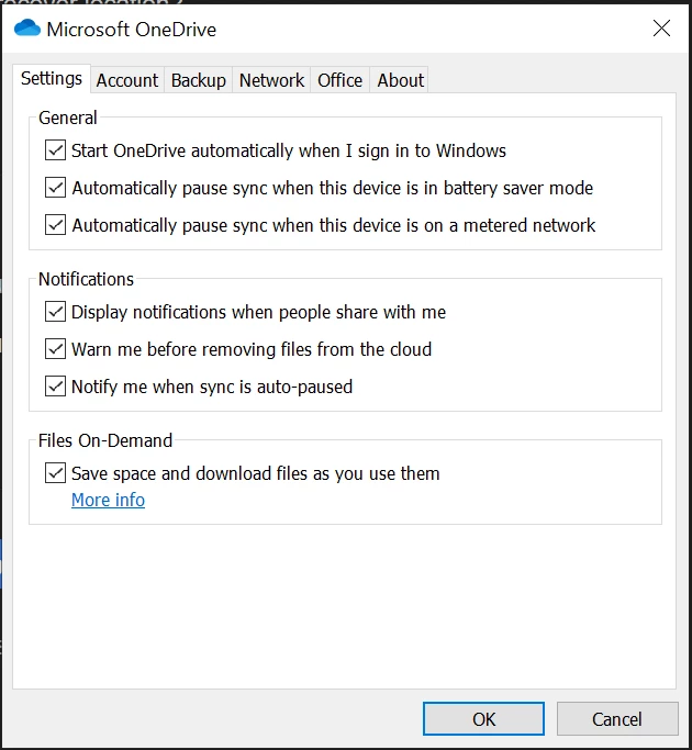

OneDrive for Business Worklet Ideas:
  • Set default “Backup” folders to sync: C:\Users%user%\Desktop | Pictures | Downloads | etc.
  • Set AutoSave On/Off and location
  • Set AutoRecover On/Off and location
  • Set other general settings:
