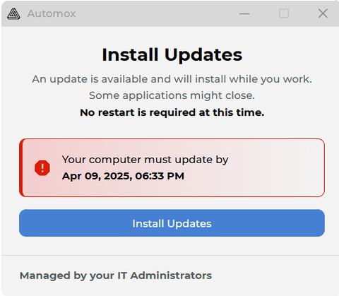

Hi
Our deployment has update deferral policies in place and up until recently they have been working as expected.
Recently, we have been getting the following message that seems to be by-passing the deferral policies.
Can anyone comment on this? Is this part of an update? And can this notification be disabled/altered.
Thanks

Hello Mike!
Thanks for your feedback on the Automox Tray. The notifications are now configured on a deadline-based system rather than a deferral based system. You can manage the deadline configuration with the policy in the console.
End-users can click the X to close the notification window if they are not ready to install patches or reboot a device when prompted. After clicking the X, they can then click on the system tray icon at any time when they are ready to progress.
Hope that helps!
