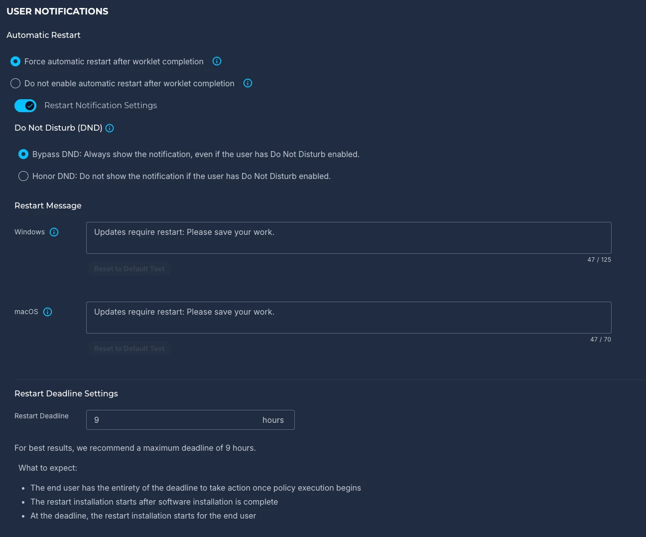

If the KB requires a restart to complete installation, you can enable restarts with notifications at the bottom of the Worklet:
Simply add a schedule to the Policy, assign your Groups and click “Create Policy”.
