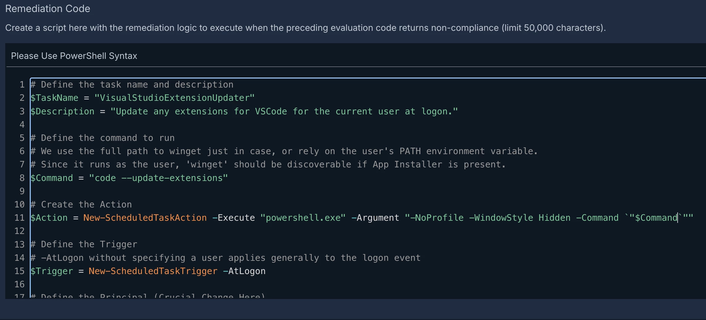

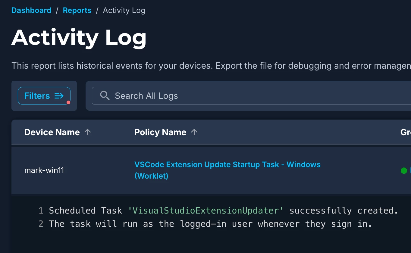

Often I will employ startup-tasks, executed on login, for user environment tasks. Heres an example where I invoke a CLI vscode command to update its extensions (which Automox doesn’t natively handle, so 2 birds with 1 stone):
Where possible, I utilize the applications built-in commands (like the above) so I don’t have to worry about deploying an actual package/payload.

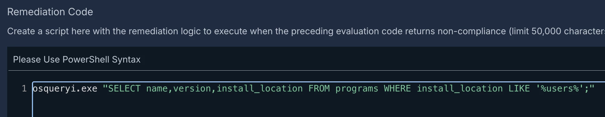

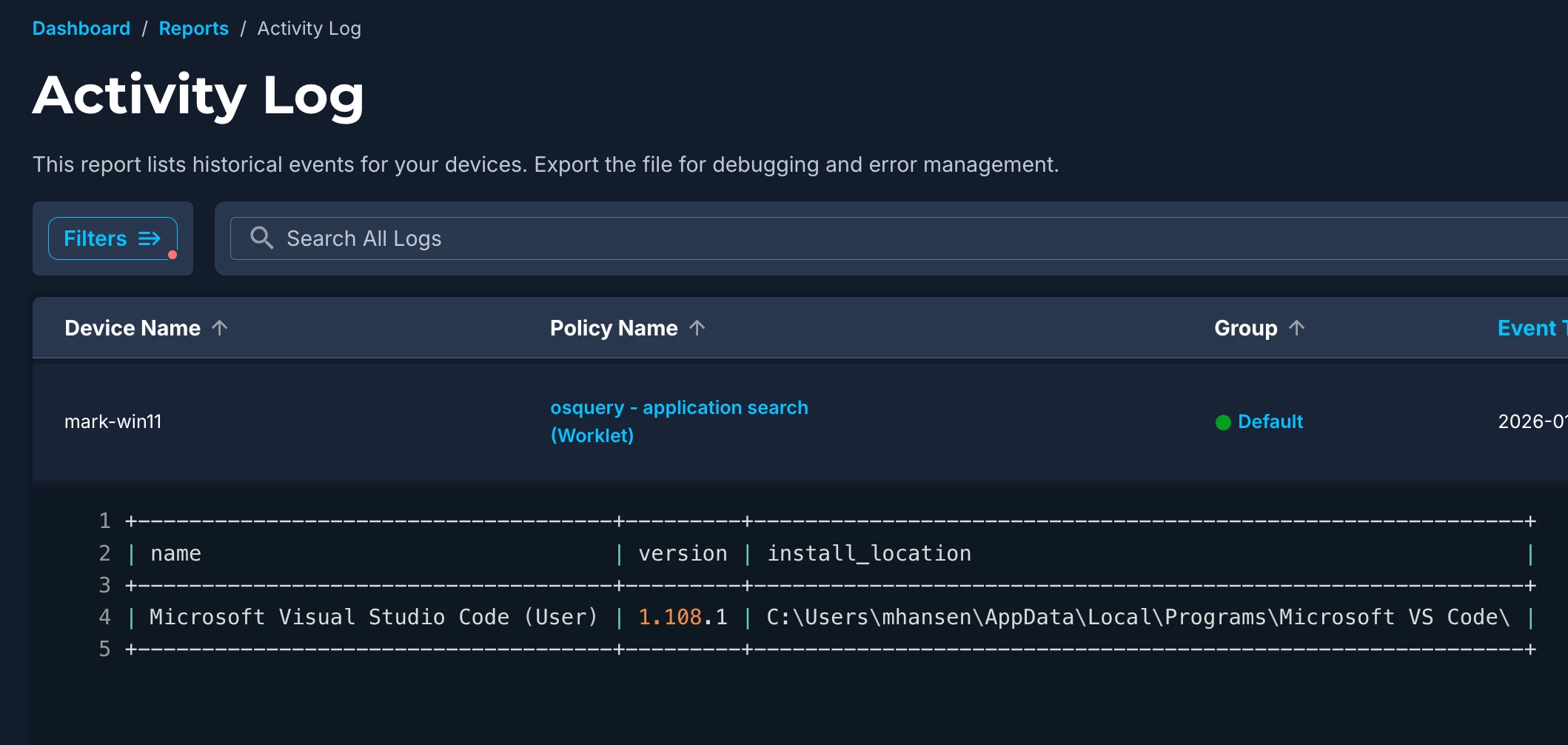

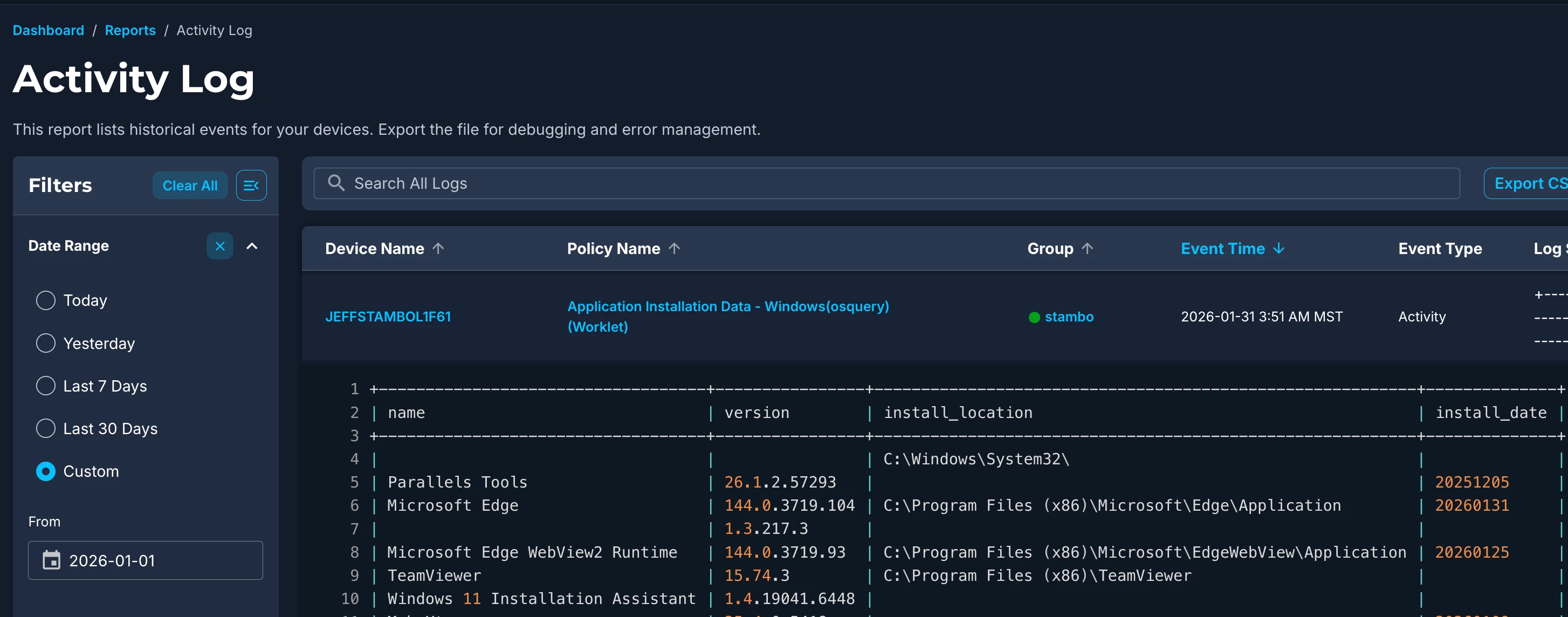

To an overview of all apps, installed directory detail, and install space, you can issue an OSquery command, which is built into our agents, like this for everything:
osqueryi.exe "SELECT name,version,install_location FROM programs;"
Or like this for user scoped out applications only:
osqueryi.exe "SELECT name,version,install_location FROM programs WHERE install_location LIKE '%users%';"
Worklet screenshot, no need for Eval code (exit 0)
The directory can vary if it was installed by a package manager vs stand alone installs.
