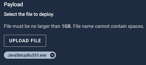

As a side note, be sure to upload your Java Install exe to the Payload portion of the worklet if you haven’t already, as this is the file that is called within the $javaInstallFile variable above:
I hope this helps!
