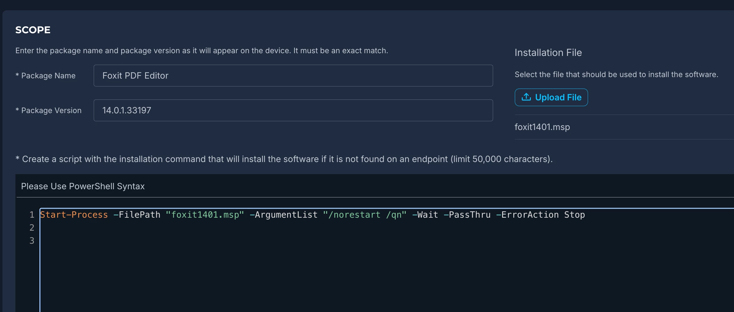

The Required Software policy requires the scope to be exact, even case sensitive for compliance.
I was able to get this updated using the script similar to yours:
Start-Process -FilePath "foxit1401.msp" -ArgumentList "/norestart /qn" -Wait -PassThru -ErrorAction Stop

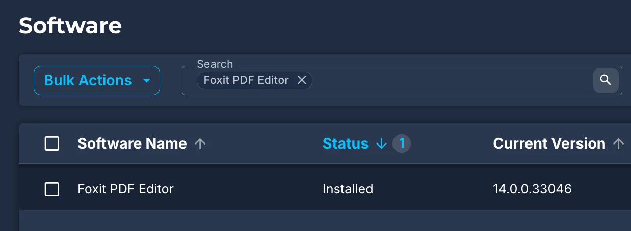

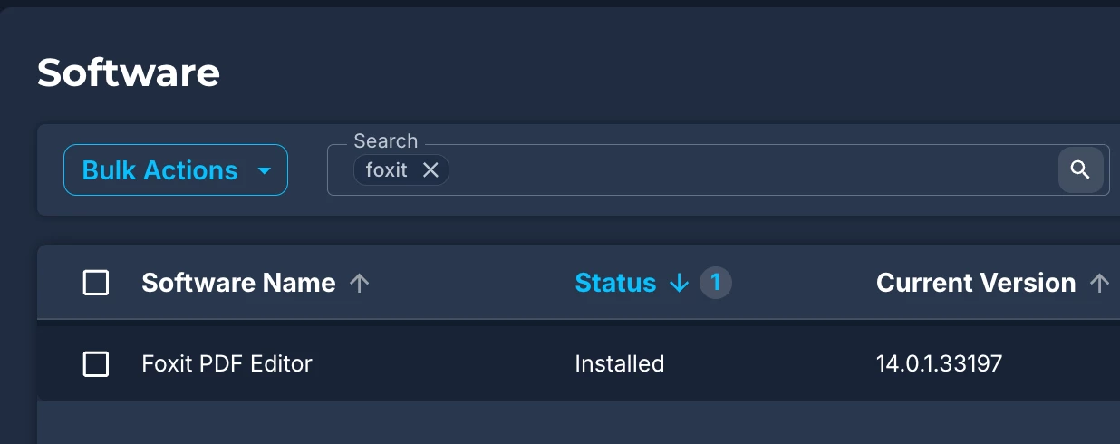

​​​​P​​​re-Deployment
Required Software Contents
Post-policy deployment
