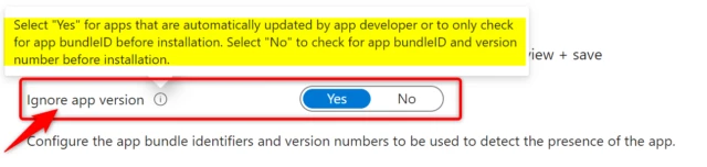

In Intune, when you build the package as a line-of-business app with the MSI, all you need to ensure is the package is set to ‘Ignore app version’. This prevents double deployment which may be what’s happening. Let our backend service handle the upgrade. Here’s the Intune package setting for the agent:
Once Intune automatically redeploys the Automox agent (if it is not installed), the Automox services will automatically startup.
