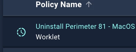

If you take a look directly at an endpoint it will show either a clock or green icon showing compliance:
Example of a non-compliant policy, this will auto-run as scheduled.
Policies can be run manually even if the endpoint is compliant, however it will not run automatically since it does not need to.

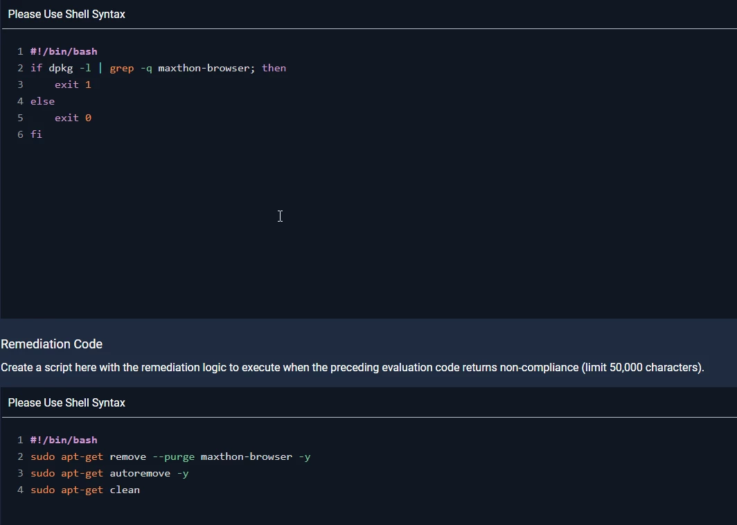

Feel free to paste a screenshot of the eval code and I can take a look at it. If you can, add a screenshot of your Required Software policy and we can look at that as well. If a device is compliant with the RS policy it also will not run:

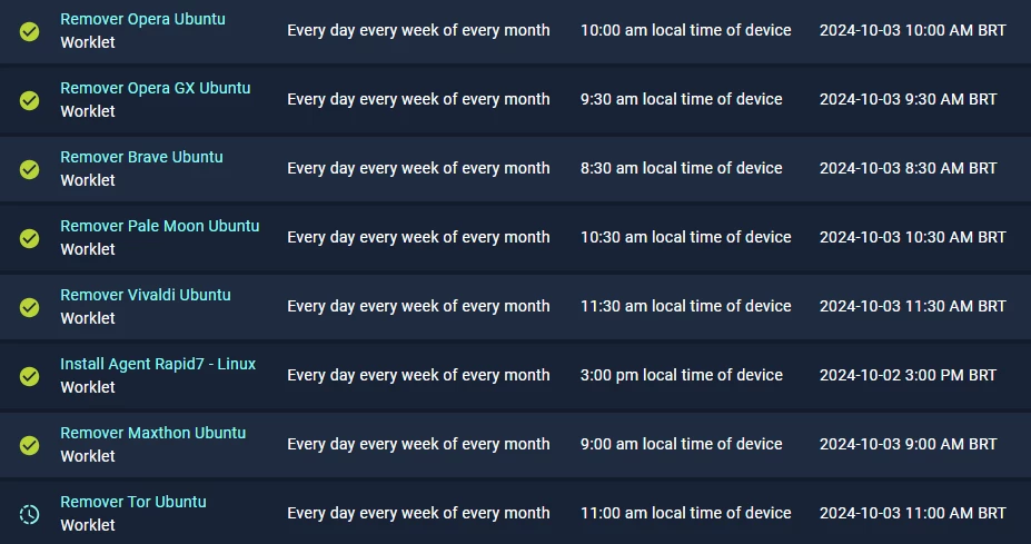

But when checking the endpoints, only one policy will be executed in the scheduling.
and this is true of all endpoints.

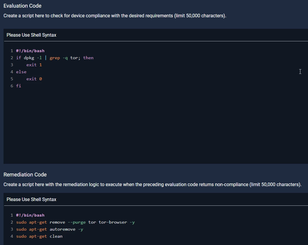

follows the evaluation code of the policy that is being executed by the schedule and gives the policy that is not.

Thanks for the screenshots. So in this case, you are saying that the Tor removal policy does not appear to be working, is that correct? The other policies are functioning?

On the contrary, tor is being executed as scheduled, the others are not.

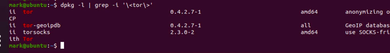

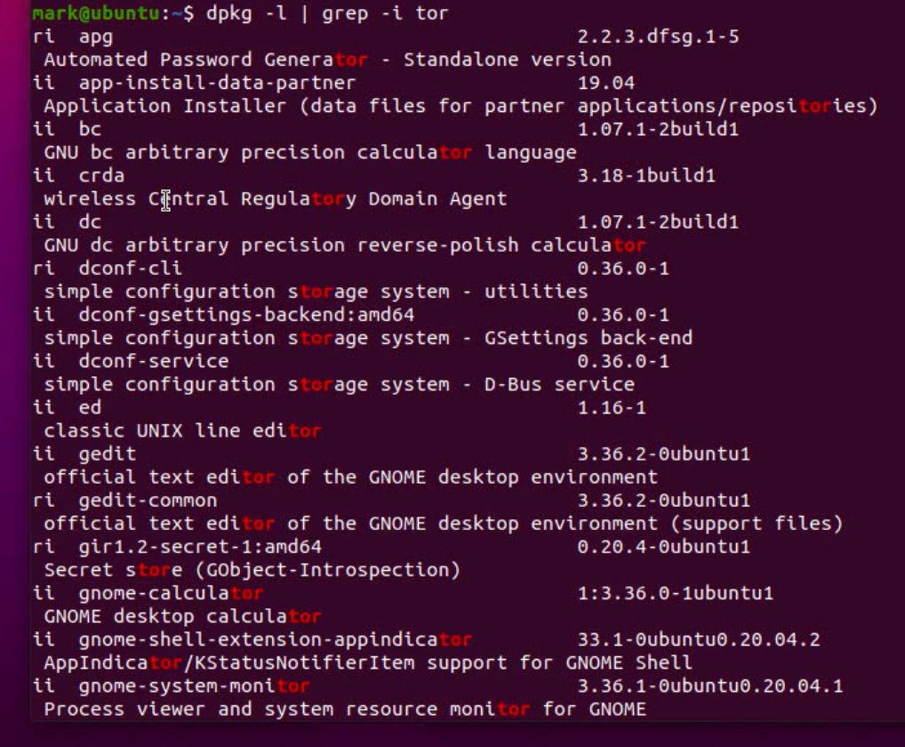

The Tor removal is being executed I believe since ‘tor’ is actually returning multiple results over and over again:
the dpkg command is returning things like ‘calculator’, ‘editor’, ‘monitor’ etc…
‘match everything that contains tor’
We specifically do not want the policies to run which sounds odd, however if an endpoint is compliant then we are happy. Its a good thing to not see the policies routinely run. It means one of two things:
Our configuration is being modifed;
OR
Our Evaluation code is not doing what we think it is.
In this case, the search for ‘tor’ is too generic. If we see ‘tor’ then uninstall the tor brower’.
The next time the Evaluation code scans there are still results for ‘tor’ and it makes the policy as non-compliant.

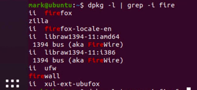

Another example, if I say ‘match fire, and then uninstall firefox’ I will still be left with these results containing ‘firewire’ or ‘firewall’ and it will fail the eval code and run the uninstaller over and over again until I change my Eval code to only match firefox.

Here is a closer example to what I believe you ultimately want, I’m no scripting expert by any means but this might get you exactly what you need (if all these items get removed with your uninstall/removal commands):

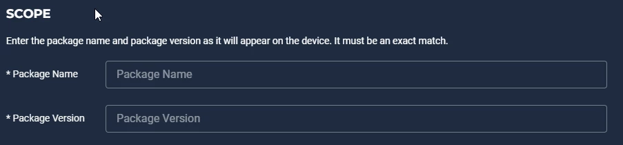

One last confirmation regarding appointments. For mandatory software policies that do not have validation codes, does the policy use the software name and version as validation?
correct?
MarkH-AutomoxOctober 2, 2024
#10
Thats correct. It is case sensitive as well.
If a software has been deployed and the device is still showing non-compliant, copy and paste the package name/version from the ‘Software’ section of an individual device into the scope of the policy.
