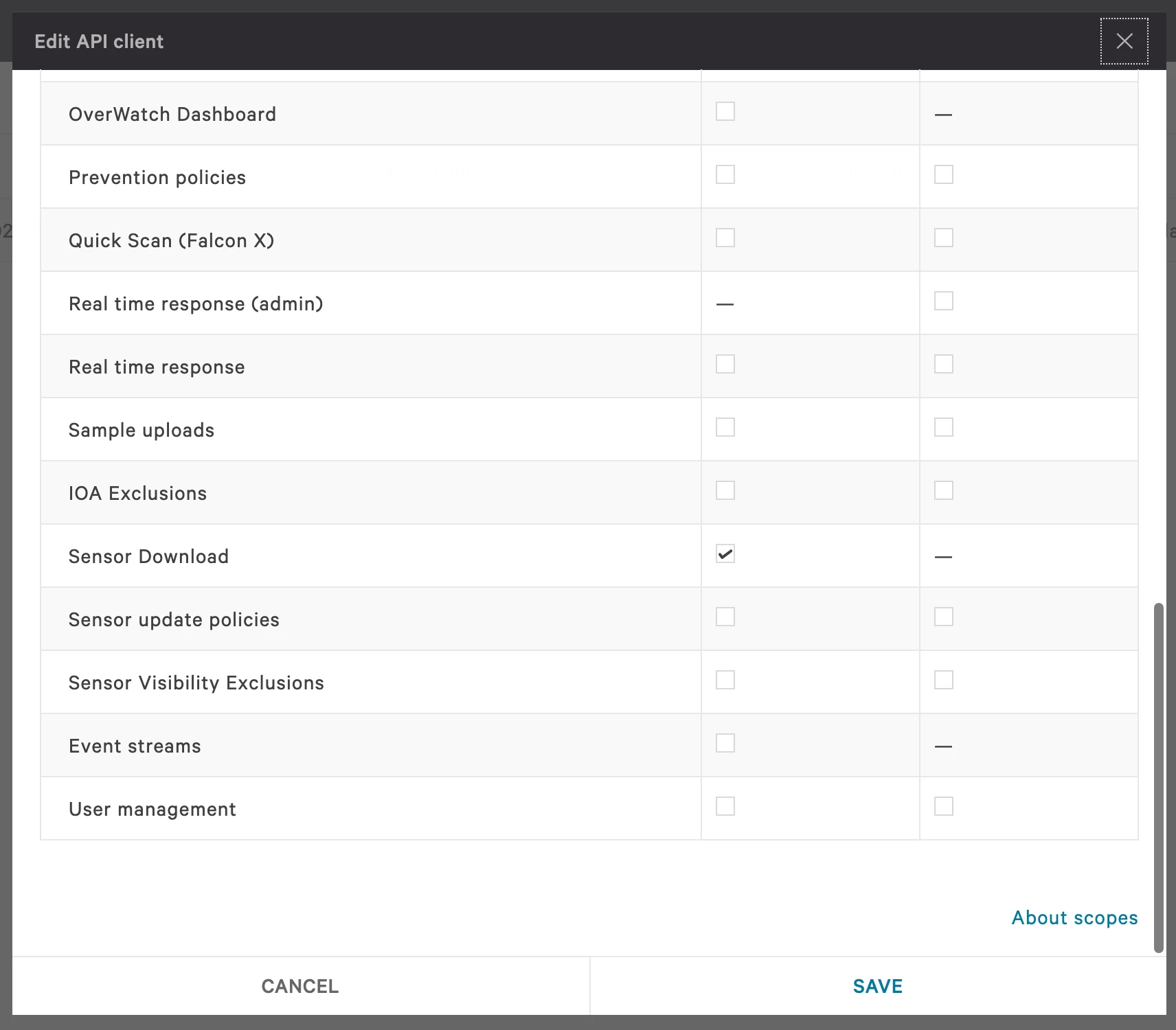

Also, you will need to click on ‘Edit’ on your newly made API client and tick the tickbox under the ‘read’ section for Sensor Download API

Did you generate your client id and api key, and select Sensor download like in the edit api ciient screenshot above?
