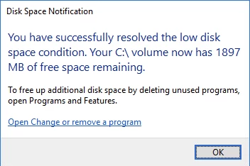

I just tested out the /verylowdisk flag and here’s the screen that pops up at the end of it:
40%20AM
You might alarm some end users (and generate helpdesk tickets) if they don’t know why they are getting that window. I’ll see if there is any other flag or way to have it run completely silently.

Ok @MFling I think I have a working prototype for this, using the cleanupmgr.exe /sagerun:1 flag, which runs the cleanup tool silently according to presets that you configure with the /sageset:1 flag. I’ll get someone to look over my code tomorrow and then I’ll post it to the Worklets section for you to try out.
