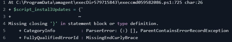

Just checking in with the same issue, which I consider to be a bug. I was only in the testing phase of a worklet I was writing, the individual components of which had all been tested in interactive Powershell sessions. The issues only arose when the complete script was pasted into the remediation of a worklet.
The backtick after the { was one of many troubleshooting attempts, based on the assumption that Automox doesn’t like me starting new lines straight after a curly brace. I also tried a semicolon, removing the underscore from the variable name, removing all blank lines and comments from the script block contents, and putting the entire script block content on a single line.
The only thing that worked was manually typing this whole section of the worklet by hand, which isn’t much fun when the Automox console doesn’t auto–complete or flag syntax errors.
The contents of the script block was very simple, by the way. Like I said, this was a dry run to test the mechanics of the script before actually making it do useful stuff.

Ken-AutomoxMay 2, 2022
#5
Thank you for the feedback, I will bring this up internally to see how we can improve the experience and help troubleshooting these sorts of issues.
For the future, this is almost always an issue with Unicode dashes and quotes. PowerShell automatically corrects those characters when pasting in, which makes it even more difficult to find the cause.
D-SWAGMay 3, 2022
#6
Thanks @Ken-Automox ! Easy workaround for now is to paste into NP++ in UTF-8 mode before pasting into Automox.
