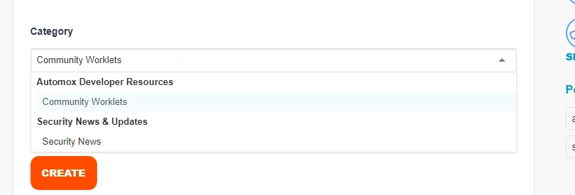

Unfortunately as I only seem to be able to post to Community Worklets and Security News sections this post isn’t going to get the audience required to gauge that.

As for why your post is showing in the Community Worklets section, I believe it is because of the code/script section. The system will automatically contain posts with code/script to those two categories.
Not to worry though, as we find most of our traffic in the Community Worklets section!

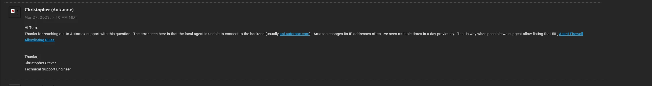

I got this reply from Automox support regarding this issue.
So my thought is that the DNS/Web filter is not updating quick enough, so the agent is trying to reach api.automox.com on the old IP and because of this sometimes crashes.

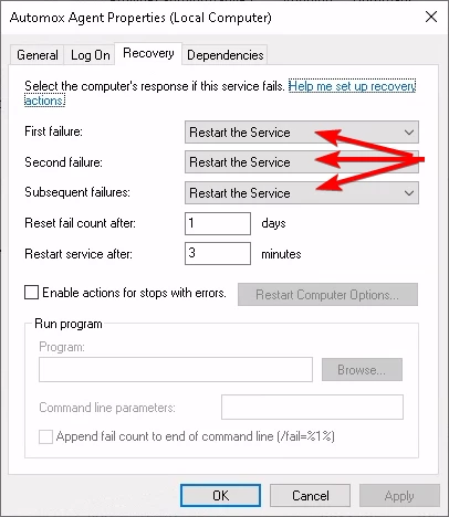

Our problems are largely stabilised.. not because the agent got any better, but because we’ve got other things monitoring if the Automox service has stopped and restarting it. In my opinion this isn’t a proper solution, but we didn’t really have much choice but to bodge it.
It beggars believe that the agents response to either not being able to connect to the Automox console OR having that communication interrupted is to crash, and then rely on the OS service managers to restart it. Is there no exception handling in the agent? I’ve never come across anything like it before in my twenty year career in IT.

1,000 times yes.  We have been experiencing the same issue and it is increasing in scale.  Automox’s solution was to create a worklet that creates a scheduled task, which makes the PC restart the agent every hour - this is not a solution imo, it’s a band-aid, and with how many others I hear discussing this issue, it’s concerning.  We started experiencing a wide array of issues immediately after we onboarded, and just haven’t seen the light at the end of this tunnel, unfortunately.
